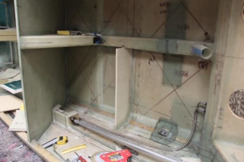

Left rear seat
Floxed in left rear seat front bulkhead, taped with 2 x BID overall, overlapping 1"
