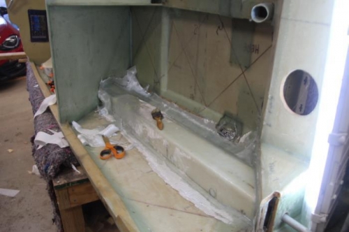

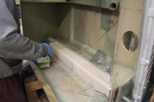

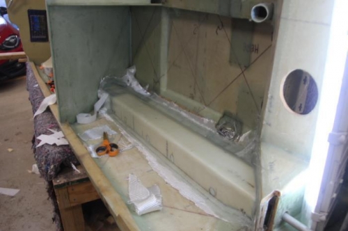

Left rear armrest outer skin
Backfilled depressions over locating pin bases with flox, prepped foam and applied 2 x BID overall, overlapping 1/2" along the top and 1" elsewhere. Peel ply on joins.
Slathering on micro
Wetting out second ply
Done
