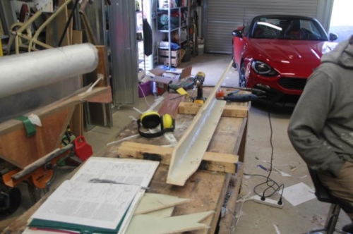

Trimmed layups, all lovely.

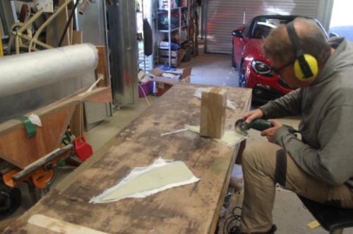

Drilled out sites for rear armrest locating pins using a 25mm spade bit, cleaning up with dremel grinding bit. Trial fit pins and discover I have drilled underneath the armrest and the plan was to drill the top. What an a55hole!!! Filled the central hole with a scrap of foam and backfilled the mistake with dry flox and covered with a 1 x BID patch.

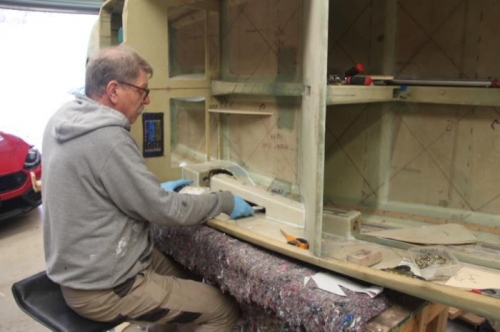

2 x BID over left front armrest, overlapping 0.5-1" all around
Trimmy, trimmy
Trimmy, trimmy
Mistake discovered, devising repair.
As expected, getting the tape to stick inside map pocket trickey
