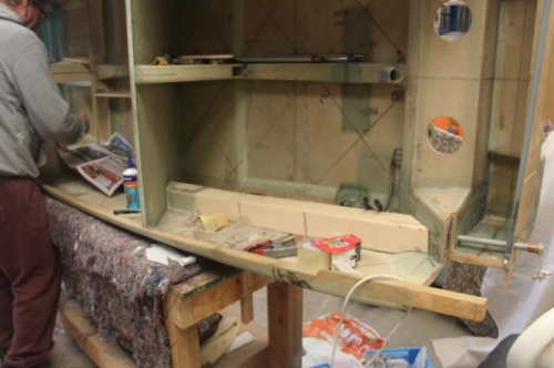

Hot glued a packing piece under opening in left rear fixed armrest, and glue up remaining foam joints in removable part. Have packed out aileron torque tubes with some PVC conduit, to ensure clearance, and relieve the inside a bit to fit with this.
Can't remember when I did this, and can't find it in my rough log, but around now remove all aileron hardware from the left side, after checking I can get it all in again.

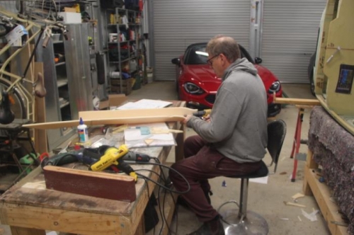

Made a paper template and cut front armrest glass.
Cut out remainder of front and rear thight support foam, despite a niggling thought I had another front set somewhere...
Discover a discrepancy between the full-size M09/15 and the plans in the shape, dimension and placement of the rear seat thigh supports, and decide to go with the plans. Make an extra baffle piece, as the right rear seat will be a sump tank, on the Vance Atkinson model.
Match drilled left rear armrest and flange for locating pins. I had drawn a picture of what I wanted for these, then wandered around Bunnings Aerospace in case there was something there that would obviate a 3-d printed part. I found some 15mm nylon tap hinges that were perfect!
Making a template for the glass
Trimmy, trimmy
Trimmy, trimmy
