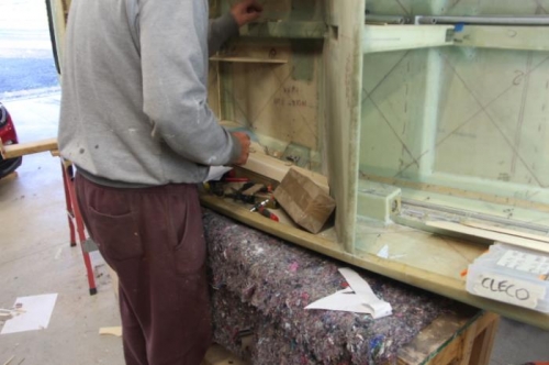

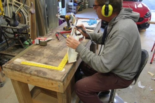

Left armrests
Trimmed parts, all lovely.
Profiled the outside of, and fitted left front armrest with urethane bond, weights and the odd nail, clamp and cleco.
After that remembered I wanted to put in some hoop pine hardpoints, did the access door ones.

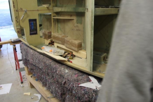

Trimmy, trimmy
Front armrest fitted
De-rig weights, and fit some hard points.
