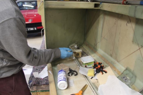

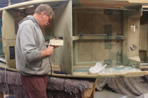

Layups all good, trimmed with dremel, multitool and sanding block.
Plans say just fit the removable bits with sheet metal screws, but I think they will pull out really easy. Make a bunch of 1/4" thick 3/4" square hardpoints from hoop pine and recess 2 into left rear fixed armrest. Fixed to fuselage side with urethane bond
Trimmed rear armrest flange to 1". Stupid urethane foam broke up into 10 bits, and may not be reusable for the right side.

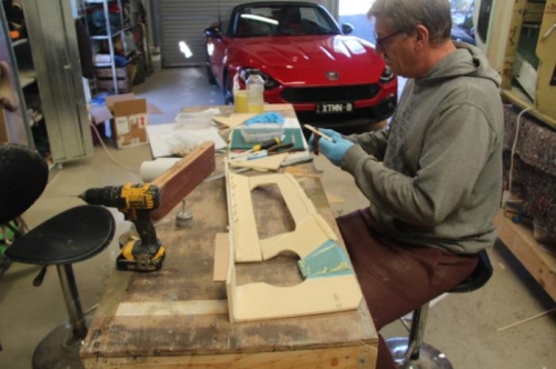

Finished remaining joints for front left armrest with 5-min epoxy.
After a break 2 x BID over rear fixed armrest overlapping 1" onto sides and ply.
Profiled inside of left front armrest and layed up 1 x BID.
