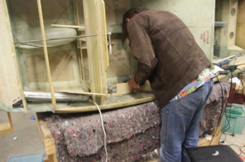

Prep sanded, cleaned and painted interior of left map pocket and fuselage side that will be inside with grey epoxy primer. Reckon it will be difficult to do this later. Realise after it has dried that I should have left some glass bare for taping, as I reckon I am committed to fixed armrests, not a modern way to do it.
When dry, installed left map pocket with urethane bond and cleco.
Removed right side bits from forms and marked for trimming.
Rough trimmed left armrest top around map pocket when I got home from work. Still getting my head around this.

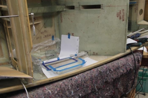

Masking off for paint, should have masked some more
