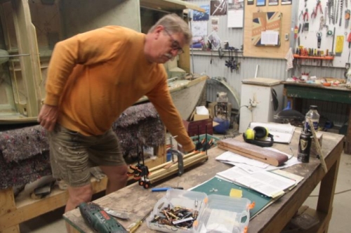

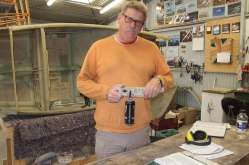

Have been following an old debate on the interweb on whether to secure cables with zip ties or nylon string and hadn't bothered with a decision yet, as my clips could accomodate either. Tried a bit of velcro tape with a 15mm overlap, which happily lifted a 5.7kg ballast weight, but separated if I swung it about. Hmmmm. This will at least work for the assembly stage.
Decided there was no reason I could not use the same sort of clips to secure the brake lines rather than flox/taping, so made ANOTHER form from 2 x 1/4" dowels wrapped in duct tape untill they are the same diameter as the brakelines, and hot glued to a taped board. Layup 2 x BID and use the previously created clampy boards.
Velcro as a cable tie???
Brakeline clips in the clamps
