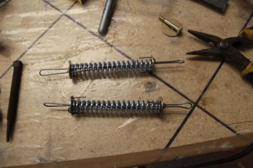

Brief Description:  Rudder springs
These springs go in the Rudder cables and let you engage the rudders, then compress and let you apply the brakes. They seem frighfully stiff, but are the specified spring, from the Century Spring company.
As suggested by Marc Zeitlen I bored out 4 AN970-4 washers to 5/16", and put in two additional holes near the perimeter to trap the ends of the retainers. All looks reasonable.
