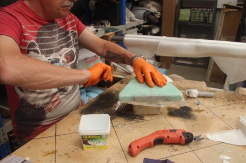

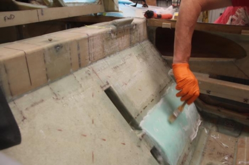

Seatback profiling and headrest
Trimmed all and gritted teeth.
1 x BID and 1 x 4oz over lumbar support, overlapping 1" on surrounds, peel plied edges.
2 x BID over headrest base, peel plied edges.
2 x BID over front and sides of headrest, peel plied sides.
Wetting out lumbar support
Front of headrest
