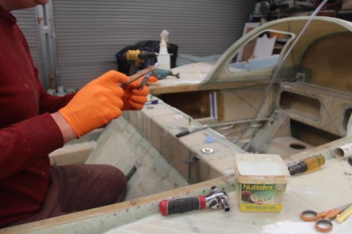

Shoulder rest harness attachments
Floxed in upper harness nutplate assemblies, clamping in place with greased hardware bolts and mudguard washers.
Backfilled slots with leftover flox
#2
Backfilling slots
