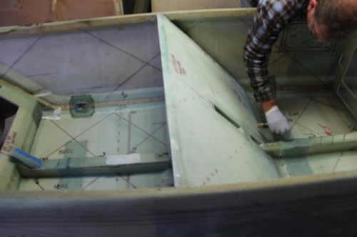

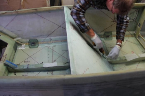

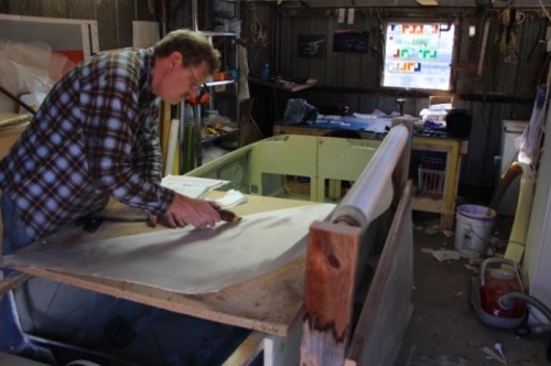

Cut out all the cloth, and refilled my 2" tape box.
Trimmed and taped the seatback opening above the heat duct, not in the plans specifically, but seemed like it should be done.

2" tapes
Taping the seatback
Taping the seatback
