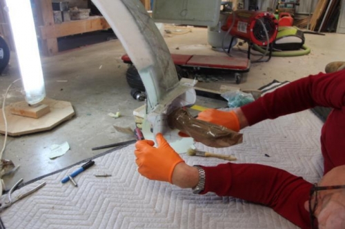

Brake fairings and heatshield
Filled up the pre-formed flox corners, 2 x BID over the remainder, wet out on the bench on peel ply.
There is a note in my rough log about an additional 1 x BID somewhere, but I remember not where...
Stipply, stipply
