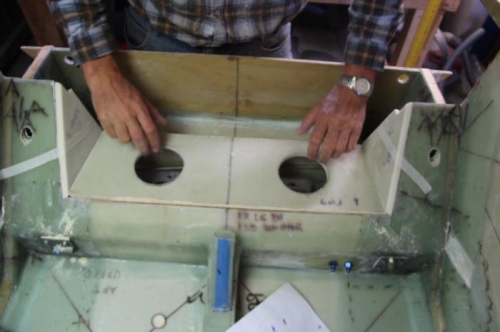

Fitted brakes and brakelines, using -3 stainless steel wrapped teflon line, and Powerflow fittings, terminating in a bulkhead fitting in the firewall.
The bulkhead fittings were a poser, the only way to get it to work was install at an angle through the bulkhead.

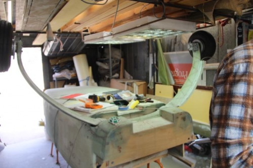

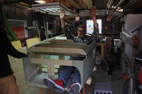

Turned fuselage the right way up, and put it on its wheels for the first time. Climbed inside and had a party :)
Trimmed MLG Inner Cover to fit.
Running brake lines
On the wheels!!!
Profiling edges Inner Cover. Bulkhead fittings on right
