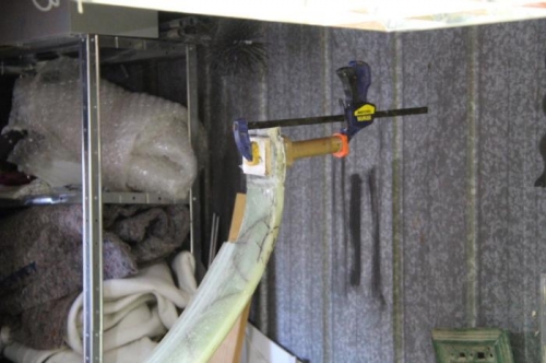

MLG Axle install
Removed peel ply and trimmed layup.
Floxed on Backing Plate, re-using PORT side one removed earlier. Drilled hole sufficiently in the cutout area to be useful.
