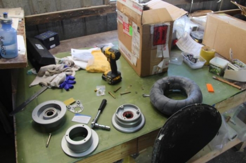

Removed clamps and jigs, and new method may have worse than the original. Axle had crept about 20 degrees from its proper alignment. Heated & knocked off.

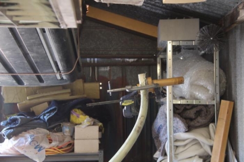

Cleaned up mounting face and Axle, refitted with flox. Figuring the jig had perhaps obscured the alignment lines, omitted jig this time, allowing alignment check with my sighting tube.
For therapy, mounted all tyres, and fitted PORT wheel with tyre on.
Inflated all tyres to 30PSI, check after a while to see how they hold.
Nosewheel tyre was a bear, had to compress the tyre to get the through bolts, erm, through. made a clamp.
Left off the jigs, MUCH easier
