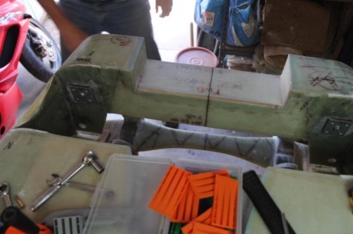

Positioned MG-1/2 with 1/4" hardware bolts. Drilled out attach holes and reamed to size. Removed bondo and reinstalled with flox and torqued down the screws/nuts.
I made these parts last year between getting my medical back and arrival of my ASS order. Faces are primed, rears are prepped for flox. Was very difficult getting the parts level, should have drawn longer level-lines prior to floxing.
Played with Bushings from CG
MG-1 & 2 positioned with 1/4
MG-1 & 2 positioned with 1/4" hardware bolts

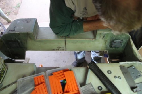

MG-1 and bulkheads all drilled out

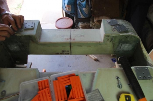

One to go. Le pant. Le phew.
