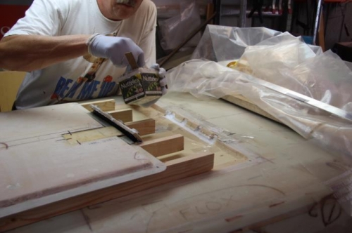

Applied peel ply to jig, for better bonding to inner layups. Not mentioned in plans.

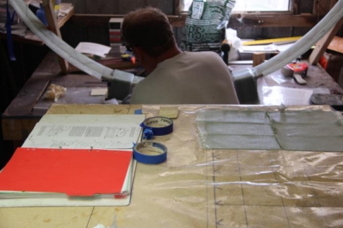

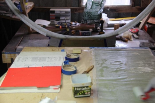

Wetted out glass over peel ply, over plastic, over my cutting template for the glass. Used a small roller with a short nap to spread the resin, FAR superior results to a stippling brush. Excess squeeged away. Wetted out 5 plies at a time, then cut with lecky scissors, and transferred to strut with the peel ply.
Did outside layup for MLG Attach Tabs, 25 x UNI, 20 x BID. Peel plied and clamped.
Installed LB hinge/LB-23/24 into fuselage bottom with micro.
Finished MLG Tab drilling jig
Wetting out UNI, 5 plies at a time
Applying BID
Applying BID
