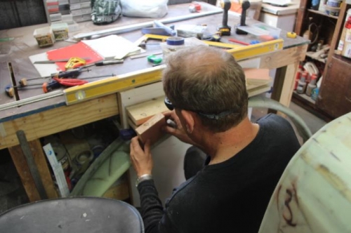

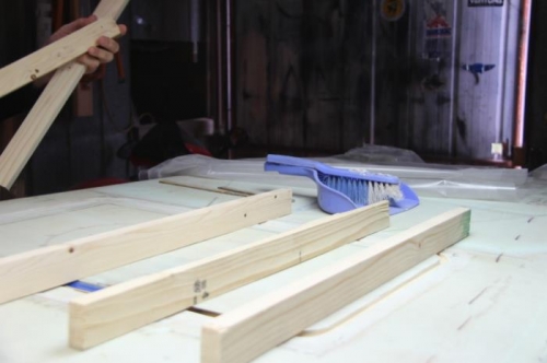

Shimmed Landing Brake level with fus bottom and bondo'd installation jigs to it.

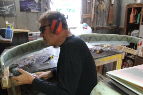

Trimmed MLG 2nd torsional layup.
Made MLG alignment jig on side of work bench, leveled and clamped MLG strut. Made MLG Attachment Tab jigs and bondo'd on. Took a couple of goes, bondo was setting REALLY quick.
Landing Brake assembly jig
Trimming 2nd torsional layup
MLG attach tab jig
MLG attach tab jig
