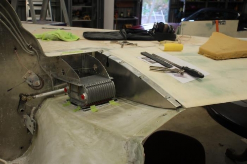

Brief Description:  Oil cooler bracket
Transfer the mockups to 0.032" 2024-T3 sheet and 3/4"x3/4"x1/8" 2024-T3 angle with generally nice results. Sadly one of the mockups got transferred by mistake and f*&ked up the hole arrangement, but I figgered it out before riveting.
Squash rivetted it all together and cleco'd to the cooler and offered it up to the firewall, and then figger out that I may have the top mount too high, and it will interfere with the bottom of the foam below the top spar inside the aircraft. Pause and reflect... Time to stir-fry some pork. And drink some fruity red...
