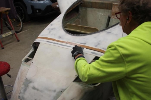

Brief Description:  Managing canopy frame leading edge gap

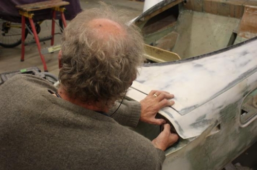

Fettled leading edge some more. The plan was to pass a slip of copy paper through the gap, and sand with 240g untill all interference is gone. This HAS BEEN ACHIEVED!!! For some physical reason that only Stephen Hawking could explain, this has left a gap under the canopy frame lip. Hmmmmm.
Taped up the canopy frame flange and FILLed the gap!
This is what an interference free canopy and a bald spot looks like...

Dog happy, so FILL, FILL, FILL!
