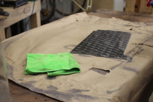

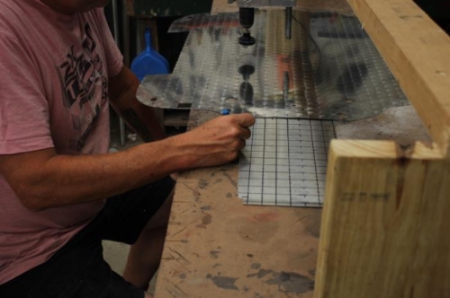

Finished off the centre piece, and transferred lines to remaining piece.
Engine turned remainder and it all looks lovely.
Cleaned both sides of firewall with metho to get rid of the marker lines, grease and wax remover until the cloth wipes clean, then a rub of acetone. Wore gloves throughout
