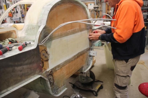

Rudder hardware firewall clickbonds
Removed rudder hardware and prep sanded starboard.
Removed peel ply and tape and cleaned threads with a cutter nut. Trial installed port hardware.
2 x BID with peel ply over starboard clickbonds.
Put a dob of acrylic paint on the outboard port rudder clickbond and trial installed metal firewall. Drilled out resulting dob.
