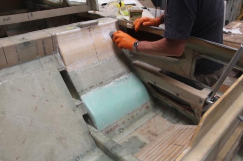

Seatback profiling and headrest
Trimmed some more, then 1 x BID and 1 x 4oz over shoulder support, overlapping 1" on surrounds.
Put 1 x BID and 1 x 4oz patches over holes in lowere seatback, leftover from locating the leading edge of the landing flap.
1 x BID over the back of the headrest and peel plied edges.
I quite bravely used colan BID thoughout. I want to make sure I have all the BID i need for the canopy frame.

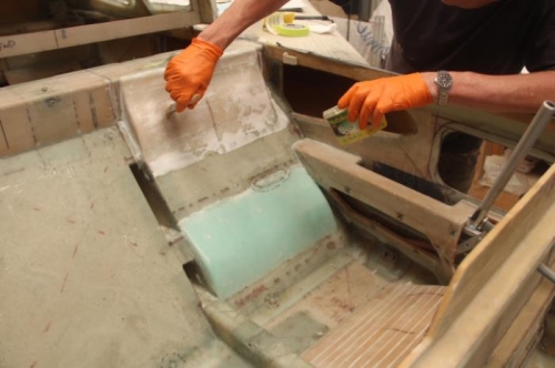

Prepping foam
Wetting out second ply

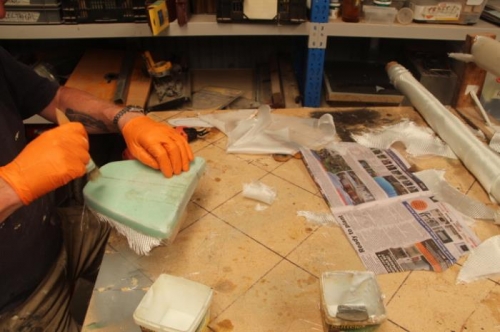

Back of the headrest
