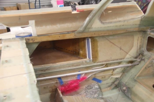

Refit all aileron hardware
Refitted all aileron hardware to fuselage, and trimmed armrests to clear this and the fuel lines. Roll action on the controls is a bit stiff, may have some flox dribbling in the CS123.
spray paint on plastic, then profile the foam where it marks
