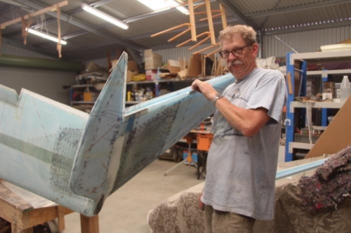

Re-re-remeasure the hinge cutouts because they didn't look right, and discover a 1" error on one side. Gloom. Also discover I don't have enough hinge to do both Rudders. Gloom.
An appropriate look when discovering a 1
An appropriate look when discovering a 1" error. Hmmmmmm.
