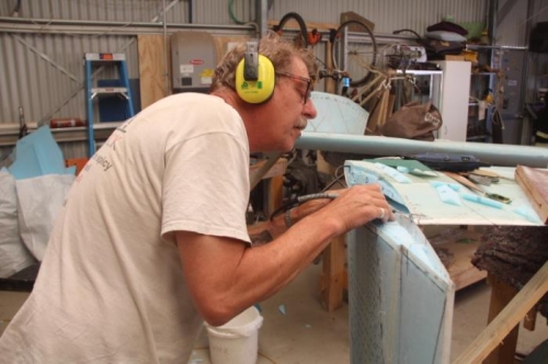

Made a 2.6mm spacer to represent Layup #1 and cut foam wedges to fill the holes. Having reviewed the investigation of a Long Ez Winglet failure investigation I prepared for a full flox corner in the wedges between Layup #1/2. Read about the result of this before you try it at home. I also spent a bit more time cleaning micro off the foam after reading :

Actually crimped a thimble to a short bit of Rudder cable, and hollowed out a suitable pocket in the wing trailing edge. Filled the pocket with taped foam.
Lets get off a bit more micro. Foam wedges prepared.
