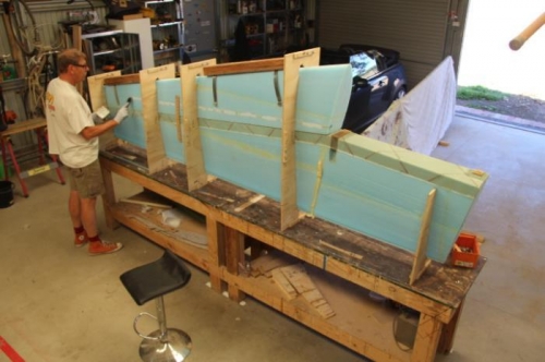

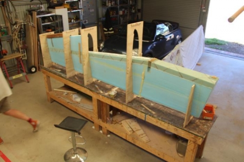

Right Wing, nose block assembly
Sanded shear web with 80g and stuck on RFC4/5 using plans micro joint because of the astounding mess last time. Much harder, but much less messy.
Patched some divots with leftover micro made dry as.
Cut out A10 Aileron tubes and prep sanded.
