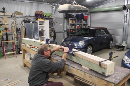

Wing CS Spar upper cap
Chocked the spar.
Cut some 2" strips of 6mm ply to dam up the side of the cap.
Hot glued mounting blocks onto the face of the shear web.
Made some clamps to hold the ply in position and fiddled with alignment
Trying out the dam strips
