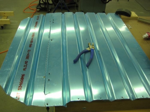

Prepare Baggage Corrugation for Priming
1412 - 1554

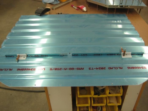

Cleco upper and lower corrugations together.
Locate the wear blocks on corrugations, match drill using #30 drill, cleco as drilled.
Match drill nut plates in lower corrugation, 4x.
Debur all holes, smooth edges, prepare for primer.
Locate additional parts for priming, including electric aileron trim parts.
Separate trim parts using bandsaw.
Smooth all edges of all parts using file, bench sander, s/b wheel.
