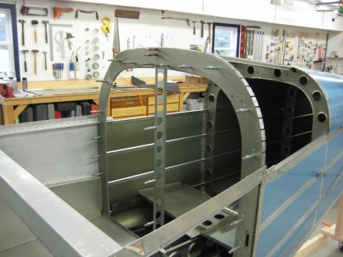

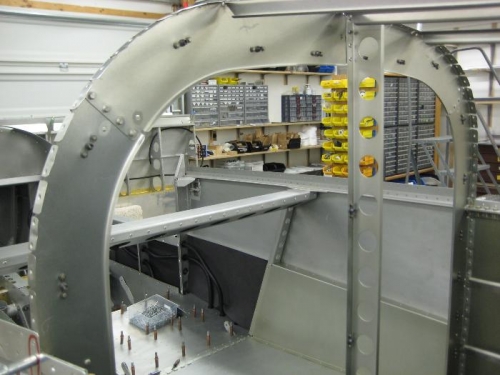

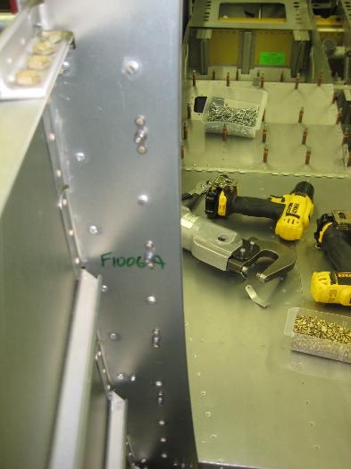

Rivet Baggage Bulkhead Nut Plates
1336 - 1412
Cleco nut plates in position on the F-1006 and bulkhead channel.
Rivet all nut plates usin p-squeezer.
