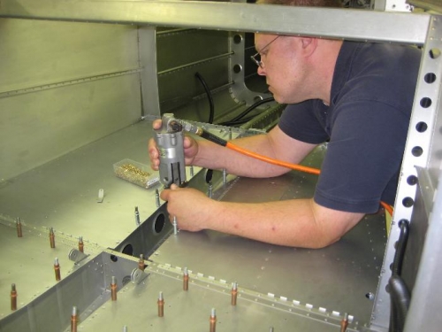

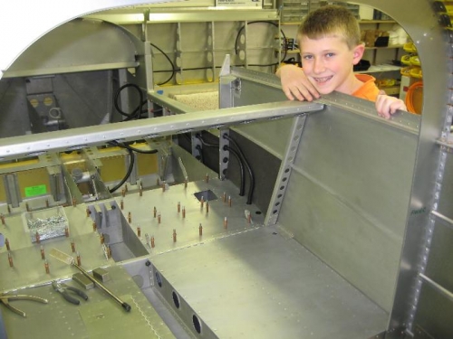

Rivet Baggage Floor
1530 - 1718
Rivet nut plates to baggage floor inboard edges and tunnel ribs using p-squeezer.
Rivet nut plates to baggage floor aft flange, bulkhead using p-squeezer.
Cleco baggage floor angles in position.
Rivet angles using 3x gun and p-rivet puller.
