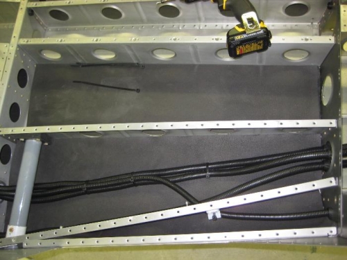

Prepare to Rivet Seat & Baggage Floors
1500 - 1618

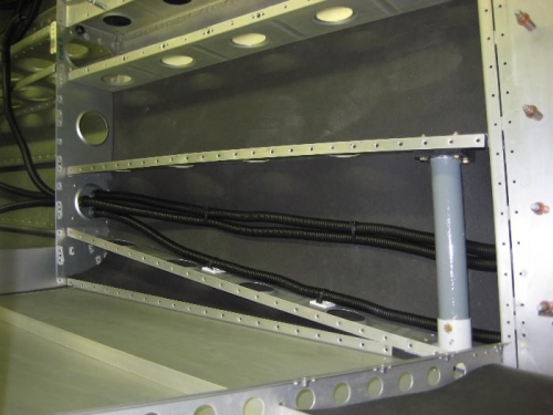

Complete conduit runs beneath seat and baggage floors.
Apply acrylic adhesive tie wrap mounts to ribs. Remove necessary insulation and apply tie wrap mounts to bottom skin.
Tie wrap conduits to mounts.
Add additional 3/8" conduit to facilitate wire run to seat back brace area. The thought is to wire baggage area lighting in this location.

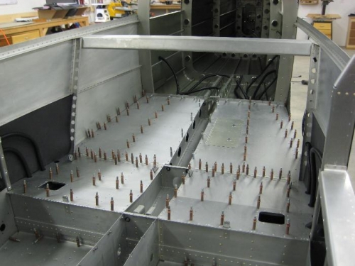

Cleco seat floors to structure.
Cleco baggage floors to structure.
Cleco seat back hinge mount in position.
