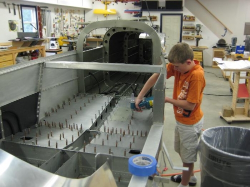

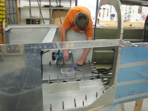

Set Kyle to riveting baggage floor with p-rivet puller.

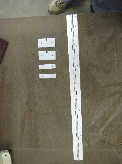

Meanwhile, I fabricated the wear blocks per 33-10.4, two small, two large.
Measure and cut baggage door hinge per 34-3.2.
Debur hinge edges using s/b wheel.
Locate, measure and mark rivet hole locations in hinge flange per 34-3.2.
Center punch and drill hole locations using 3/32" drill and drill press.
Debur holes.
