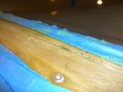

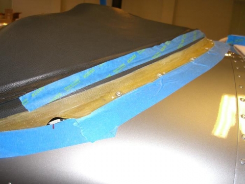

Because the windscreen has been trimmed so much at the factory, I need to maximise the bonding area at its base. Today I trimmed as much leather from the dash as I dare, reglued some of it that had come unglued and sanded the fibreglass to remove the remnants of glue.
Masking where to trim
Used a very sharp knife
Another 5mm of bonding area
