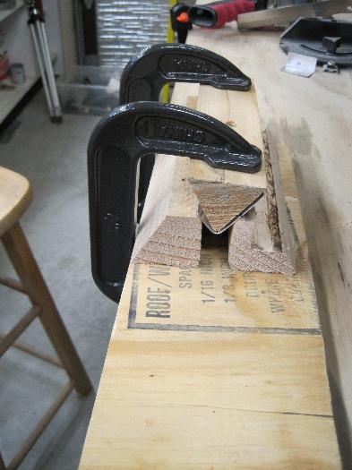

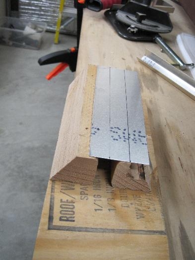

Brief Description:  Form sample of Z-angle
I am preparing to resume my build. One item under consideration is to add stringers to the wing similar to the stringers that CZAW put on their SportCruiser follow-on the the 601XL. There are 2 Z-angle stringers on the top of the wing and 1 on the bottom. They pretty much go the full span of each wing, so I anticipate needing stringers about 12 ft long. Some time ago Craig Payne posted photos on the Matronics site showing a method for forming L-angles using a wooden die cut from a 2x4. I decided to try to adapt the technique to forming a
