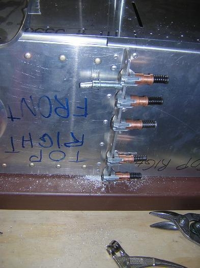

1. Drilled left NR#7 to match the holes on the spar end flange. See Fig. 1.
2. Clecoed left NR#7 in place. Unfortunately, the prepunched holes on the nose skin are too far outboard to meet the flange distance specs for a left NR#7 on the right wing. So ...
3. Talked to Caleb and suggested that I shim between the spar end flange and the left NR#7. Caleb said that is what he would do. So ...

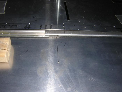

4. Cut 2 .040 shims.
5. Clamped shims to the spar end flange and drilled, 3/32", 1/8", and #20. See Fig. 2.

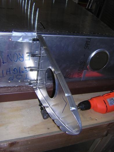

6. Put the nose skin back in place. The prepunched holes now meet the flange distance spec, as shown in Fig. 3.
Left flange clecoed as right NR#7
Drilling NR#7 shims
Drilling NR#7 shims
Nose skin & shimmed NR#7
