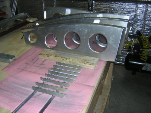

1. There has been considerable discussion by plans builders on the Zenith Forum regarding bowing of the rear ribs after the lightening holes are flanged. Some builders removed the bowing by carefully rolling the edges of the flanges. Others suggested adding a stiffener to the ribs to remove the bow.
2. Since I hadve 8 186-mm stiffeners that I couldn't use for ribs 1-4 because I had trimmed the corners at 30°, I decided to rivet these stiffeners to L & R ribs 6-9 to correct the bowing.
3. Before proceeding I calculated the approximate added weight. The 8 stiffeners weigh 88g after drilling pilot holes, or 11-g/ea. 20 A4 rivets weigh 19-g, but the mandrels weigh 14-g. So the installed rivets weigh ~0.25-g/ea, and 40 rivets weigh 10-g. Then, the 8 stiffeners, installed, will add ~98-g or ~3.5 oz.
4. Draw rivet lines 10-mm from the edge of each stiffener, and mark 5 evenly spaced holes.
5. Pilot drill the stiffeners, 3/32" . See Fig. 1.

Pilot drilled stiffeners
