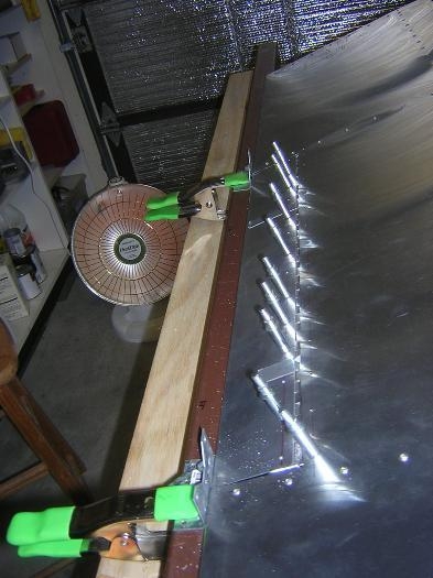

5. Clamped the 90° angles to W-rail, and then used the angles to position the trim tab so that the trailing edge of the trim tab was aligned with the trailing edge of the aileron. See Fig. 1.
6. Drilled #40 and clecoed the hinge to aileron.

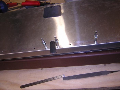

7. Removed the hinge and aileron. Then marked the mid-point of the the channel. Removed the channel and marked the 20-mm cutout on the channel.

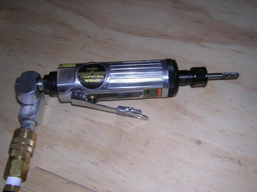

8. Used snips to rough cut the channel cutout. Then I used a rotary file in my die grinder tp cut up to the line. See Fig. 3. Smoothed the cut and deburred with a hand file.
9. Repeated the cutout process to cut the notch in the bottom skin. See Fig. 2.
Drilling hinge to aileron
Control rod cutout
Control rod cutout
Die grinder + rotary file
