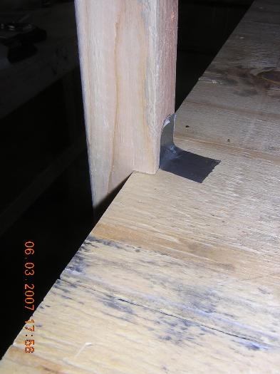

Worked on storage shelving constructed from shipping crate plywood plus OSB board.
Uprights were ripped 2x4x10's with 5/8" notches sawn for the shelves.
Each shelf was attached to the uprights with a single 1.5" screw from the shipping crate.
Nine of the shelves were cut from the 9/16" plywood from the top of the shipping crate.
The other 3 shelves were from 9/16" OSB board.
The tops of the uprights were tied to an eyebolt attached to a floor joist in the ceiling of the garage.
The 19" x 48" size was chosen to maximize usage of the crate plywood.
Bottom shelves
Bottom shelves
Shelf attachment detail
