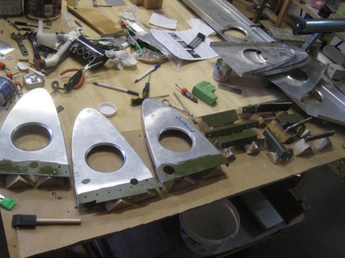

Brief Description:  Disassemble, deburr, scour, clean, and prime left
The attachments and doubler assembly for the left wing were:
1. Disassembled
2. Deburred
3. Scoured with ScotchBrite
4. Wash with camp fuel
5. Primed with zinc Chromate primer from Aircraft Spruce. I used a 1" wide foam brush to apply the primer. I thought that the foam brush gave a smoother paint layer than the brushes used on the right spar.
Primed left wing nose rib attachments
