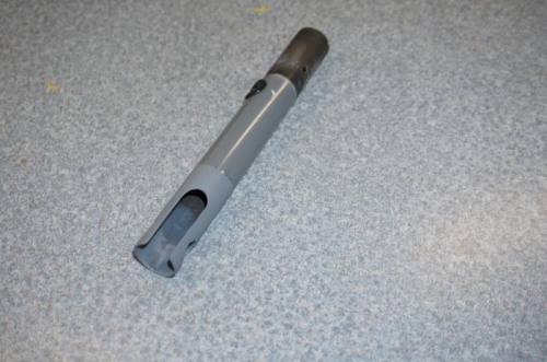

Trimmed the rear stick to length and drilled the holes and slot for the infinity stick grip. Primed the cut end. Drilled a 3/8 inch hole in the stick for the trim and push to talk switch wiring. Installed a grommet in the hole.

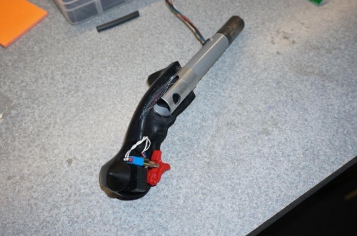

Installed the stick grip.

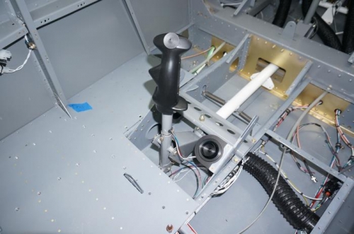

Removed the seats and cabling floors.
Mounted the air vent bracket that came with the rear stick boot from Classic Aero Interiors. The bracket mounts to the air vent mount that Van's incorporated into the support for the pilot's RH lap belt. Installed the eyeball vent (purchased from Steinair). Cut the vent hose to length and connected it to the eyeball vent.
Spent some time considering options for mounting the CPC connector for the rear stick wires (trim and push to talk switch).
Rear seat stick cut to lenght and for grip
Infinity stick grip being installed
Rear stick installed
