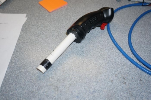

Fabricated a mock up rear stick out of PVC pipe for use in figuring out how long to make the real stick. This took a lot of time and two attempts to get right.

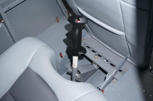

Temporarily installed the horizontal stabilizer and the elevators so that I could move the sticks forward to the limit of the travel (against the forward stops) and then determine how the long the rear stick can be without the stick grip hitting the back of the front seat.
Removed the horizontal stab and elevators.
Mock up rear stick
Mock up rear stick
Mock up in place for fit check
