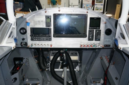

Clecoed the forward top skin in place to double check wire clearance when the panel is pulled aft to line up the rivet holes. Everything looked good.

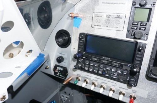

Made some changes in the labeling. Printed out transparencies and taped them in place.
Used double-sided tape to tape the cabin heat controller in place to aid in the placement decision. Placement looks good.

Panel with top forward skin clecoed in place
Cabin heat control knob taped in place
