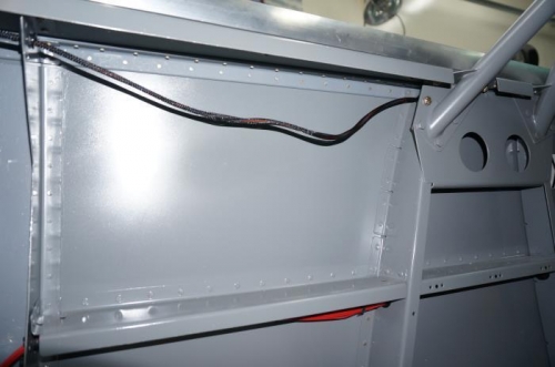

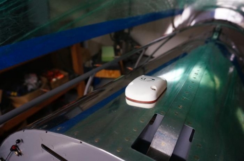

Drilled mounting holes in the upper tailcone skin for the Skyview GPS 2020 antenna.
Placed expandable sleeving on the GPS antenna wire harness

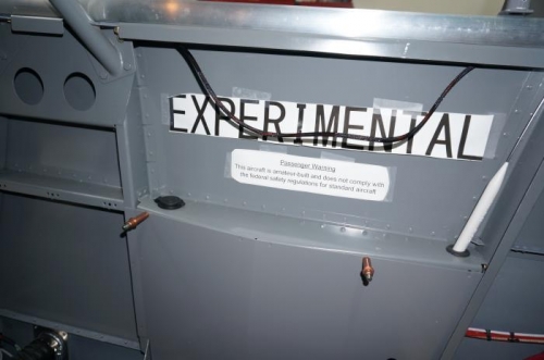

Drilled holes at the top of each of the RH side bulkheads in the cockpit. Installed snap bushings and routed the GPS wire harness through them and into the forward avionics bay.
