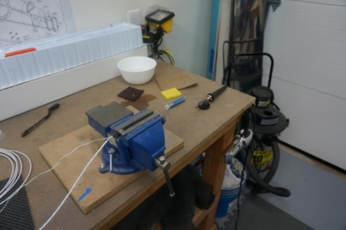

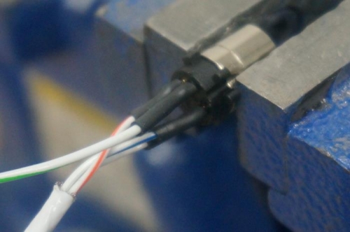

Attached the mini-doin connector to a three conductor cable to make the harness for the ELT.
Soldered each of the wires to the pins in the mini-din connector (not easy). Installed heat shrink tubing to cover the exposed wire/solder/pin. Soldered a short piece of 24 gauge wire to pin 2. This wire will be used for checkout of the ELT after installation.
Applied clear RTV between the pins and wires and installed mini-din housing.
Soldering the mini din connector to the wire harness

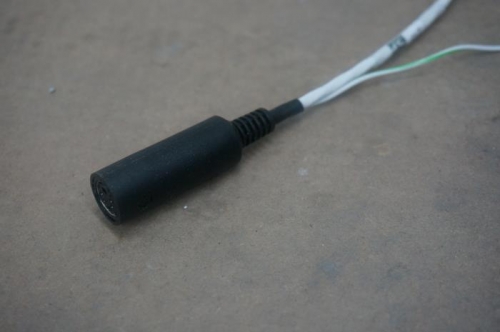

Mini din housiing in place
