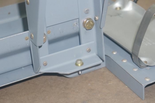

Brief Description:  Completed E-bus fuse block holder and routed wires
Added a lower support for the E-bus fuse block holder to prevent it from flexing.

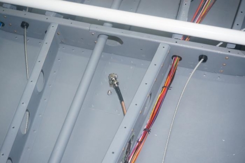

Installed Adel clamps to attach the main wire bundle from the aft fuselage avionics bay to the under floor intercostals.
Cut the ADS-B coax cable in preparation for installing a BNC connector to the forward end, but I cut the cable too short. As a result the entire cable had to be removed from the wire bundle and replaced with a longer one.

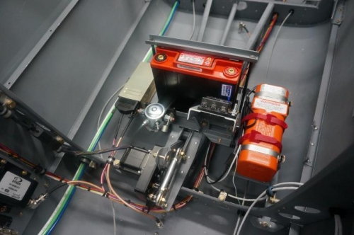

Reinstalled the batter tray and all of its attached components.
Lower support for e-bus fuse block holder
Wire bundle fastened to under floor structure and ADS-B coax
