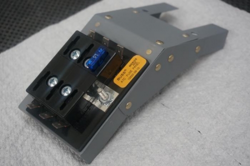

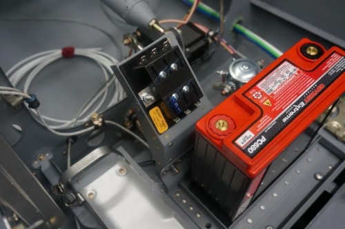

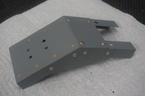

Dimpled, countersunk, scuffed, cleaned and primed the parts for the E-bus fuse holder designed to mount on the back of the battery tray. Mounted the fuse block to it and mounted it to the battery tray
E-bus fuse block bracket for revised location
With the fuse block in place
Mounted to the battery tray
