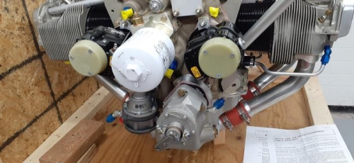

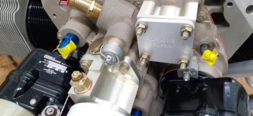

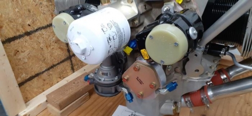

Installed the fittings for the oil cooler in and out lines (had to remove the RH magneto again to get to the oil cooler in fitting).
Installed the Dynon oil temperature sensor in the top of the oil filter housing
Removed the governor adapter cover and trial installed the governor. I'll need to remove it again to change the clocking to the actuator lines up with the governor control cable
Pulled the spark plug from the #3 cylinder and inspected the cylinder walls. No sign of corrosion. I was planning to install the desiccant plugs but they had already turned pink indicating that they are moisture saturated. I'll cook the desiccant in the oven to dry them out and then install the descant plugs.
