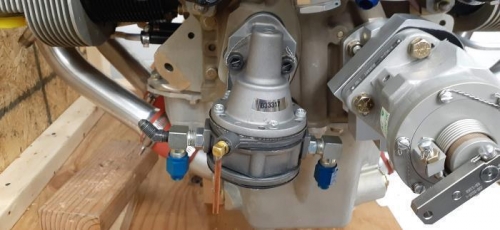

Brief Description:  Engine Prep Part 3
Replaced the fittings in the engine driven fuel pump with the ones specified on the Van's drawings. I had to remove the governor adapter to get the inboard one out
Realized that the governor needs to be installed with studs rather than the bolts that the governor pad cover was installed with. Did some research to determine the correct studs. Ordered from AC Spruce
